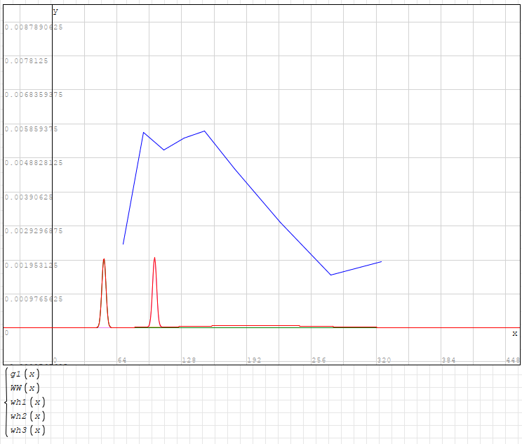

Colleagues.
I have a problem when using it. And I'm not very good at math.
I need to with the sum of three normal distributions.
I have determined the approximating function of 9 parameters, but the iteration of the parameter values to find the minimum of the smallest sum of squares does not go. The program writes that my expression is set incorrectly.
Meaning - Sq(h1,h2, h3, µ1,µ2,µ3,σ1,σ2,σ3)
Could you tell me what I did wrong?
Solution file (01.sm) I attach - 01.sm (31 КиБ) скачан 77 раз(а)..
P.S. I'm sorry, I don't speak English very well

#5 Опубликовано: 09.06.2021 08:38:18
anatolsen
anatolsen
0 сообщений из 16 понравились пользователям.
Dear alles,
Thank you for correcting my mistake.
But the desired result still did not work.
There, for some reason, the search of options stopped at the value of hh1 = 0.01, respectively, and hh2 = 001, hh3 = 0.01. That is, h1, h2, and h3 were only checked when the value =1.
Whereas I expected that the iteration of options should reach hh1 = hh2 = hh3 = 1, respectively h1 = h2 = h3 = 100.
For other parameters, it also seems that the search for options has not reached the end.
That is why the resulting graph shows a complete mismatch between the original data and the approximating formula.
I don't have an error in the If statement?
There I put continue in the else field.
eng-min.sm (32 КиБ) скачан 77 раз(а).

Your iterations are ill and wrong if this is not intended. Let me explain.
When sigma.3 reach 150, sigma.2 becomes 2. But sigma.3 doesn't start from 1 after it.
It has to be reseted to 1 but not on your algorithm.
Using a for loop is much more sense here.
But beware, when all ranges multiplied we reach 1.35×10¹⁹.
This means your algorithm is trying to calculate 1.35×10¹⁹ times.
Even 1×10⁶ takes 30 second on my pc. That algorithm will take very long.
I think we can't see the result of your problem in a human life time.

#13 Опубликовано: 13.06.2021 18:03:16
anatolsen
anatolsen
Dear overlord
I decided to take a simpler case for now, when we approximate the sum of two distributions.
With some tweaks, the time limit can be circumvented. Although I haven't tried the Fit function yet. Perhaps it will give you a gain in time.
Can you tell me how to limit the accuracy of the calculations? There Sq is calculated with an accuracy of 15 decimal places, while 9 digits are quite enough for me. This would give you a gain in time.
The approximation is quite satisfactory. The defined integral differs from the original value by only 1.5%. Given that the raw data is quite rough, there is actually a histogram, this is quite acceptable.
But I still need to calculate the Pearson correlation coefficient, and I'm faced with the fact that the reference book does not specify how to find the sum of the elements of any vector. Can you tell me what you can do in this case?
Pirson-0.sm (14 КиБ) скачан 73 раз(а).

#20 Опубликовано: 14.06.2021 12:16:14
anatolsen
anatolsen
Problem is that we don't know what you are looking for.
Are you looking for the best fit to your data set ???
If so, minute job.
Please, don't hesitate ... Jean
So I wrote down what I needed at the very beginning.
There is a data set (two rows of numbers).
Basically, they should be random sets.
However, in reality, two or even three different data sets are mixed there.
I need to separate them - to identify those normal distributions that correspond to pure data sets (not mixed data sets).
In the previous replica of for overlord, I posted the full calculation method.
Now only one question remains. Iterating through 9 parameters requires a lot of time. And the calculation is carried out with an accuracy that is superfluous for my purposes.
Sq and Sqmin are calculated with an accuracy of 15 decimal places. And I would have more than enough 8 or 9 digits after the decimal point.
This would significantly reduce the calculation time.
And here is the Pearson correlation coefficient I have 0.9999, whereas I would have more than enough 0.9
On the other hand, perhaps the Pearson coefficient should not be worsened.
Here in that calculation (in the previous replica) I had an error after integrating 1.5%, and I slightly knocked down the parameters, and it increased to 2.4%.
And this is more important than the Pearson coefficient. I would not count it at all, but I will definitely be asked a question about this coefficient.
There the definite integral is taken WW(x). And it is equal to 0.9658.
And initially I have a histogram g2(x), and if you take the integral of it, it will be equal to 0.99.
And in my case, this is more important than the Pearson coefficient.
