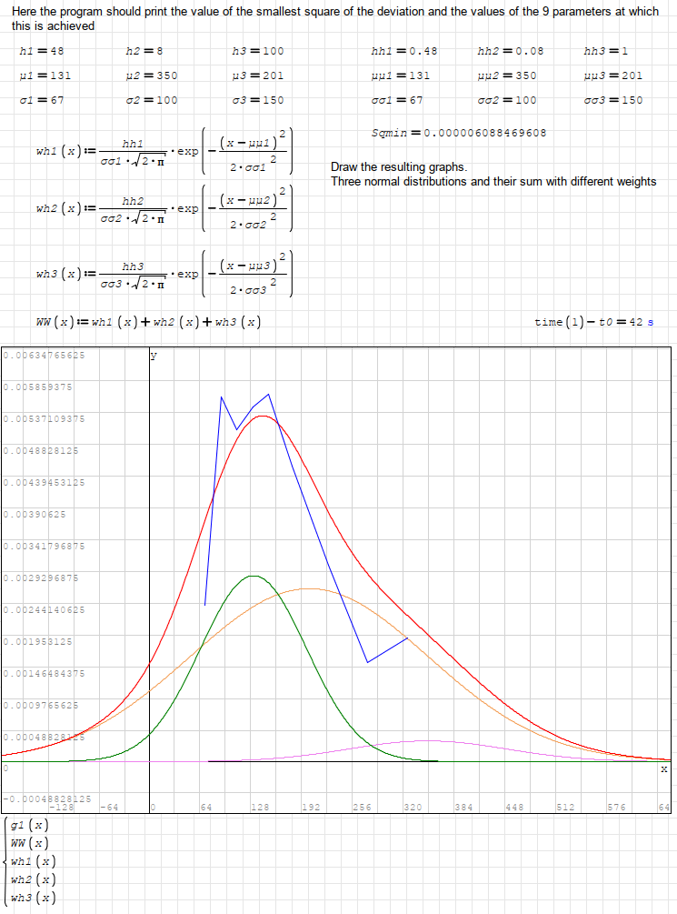

Now only one question remains. Iterating through 9 parameters requires a lot of time. And the calculation is carried out with an accuracy that is superfluous for my purposes.
Sq and Sqmin are calculated with an accuracy of 15 decimal places. And I would have more than enough 8 or 9 digits after the decimal point.
This would significantly reduce the calculation time.
And here is the Pearson correlation coefficient I have 0.9999, whereas I would have more than enough 0.9
Here is your Sq and Sqmin calculations.
I have noticed Sqmin make a peak to lowest and rise again at some point.
I coded to find those points range within first iteration.
This is done by evaluating variables one by one, not all at one.
All iterations are taken under 5 seconds on my PC.
Please inform if this results are enough for you.
eng-min_rev_fast.pdf (617 КиБ) скачан 71 раз(а).
eng-min_rev_fast.sm (40 КиБ) скачан 75 раз(а).
#24 Опубликовано: 15.06.2021 19:13:29
555 сообщений из 1333 понравились пользователям.
A revised Sq and Sqmin calculations of previous.
All iterations are taken under 25 seconds on my PC.
Sqmin is dropped to 6x10^-6. And now I am out of ideas.
eng-min_rev_fast.pdf (671 КиБ) скачан 81 раз(а).
eng-min_rev_fast.sm (47 КиБ) скачан 78 раз(а).
