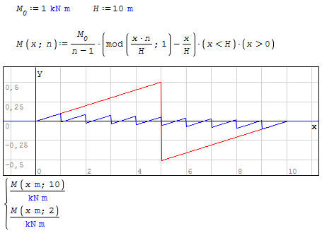

#6 Опубликовано: 05.11.2019 18:47:15
1222 сообщений из 2150 понравились пользователям.
Now with proper scaling
saw1.sm (5 КиБ) скачан 61 раз(а).

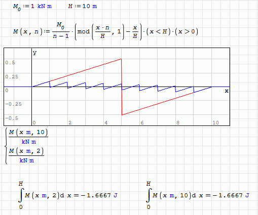

#9 Опубликовано: 05.11.2019 21:47:57
Alvaro Diaz Falconi
Alvaro Diaz Falconi
Just for show why the Martin solution it's correct:

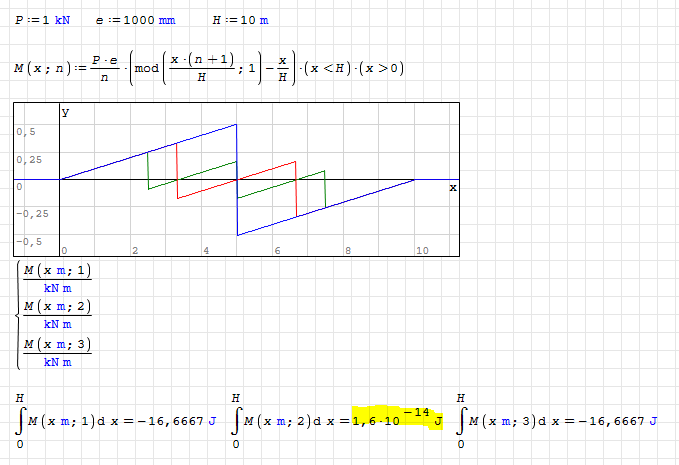

Interessting. I have tweaked Martins equations - now n represents the number of loads, not the number of segments between loads/supports.
Any idea why the integral gives me this result? Also, my integral is 10x the value of yours.
Best regards,
