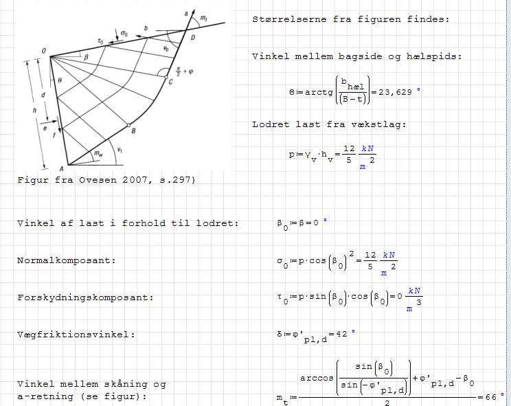

I have done a calculation on a retaining wall, which suddenly has become corrupted. Smath will open the file, but won't display most of it. The last pages are missing, and there is just a red error dot on the last page (see pic)
Показать спойлер
Stottemur.sm (491 КиБ) скачан 67 раз(а).. Is it somehow possible to restore this?

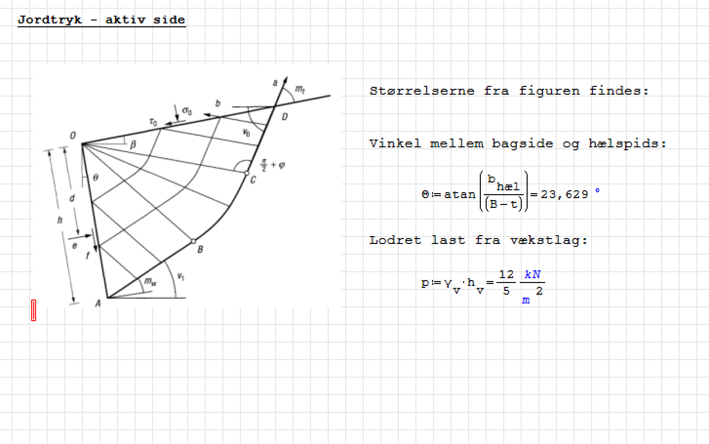

Here you are:
Stottemur_Kr.sm (491 КиБ) скачан 64 раз(а).

#4 Опубликовано: 15.05.2017 17:50:11
Smath is capricious with some plugins. If an image region has not completed
[right or wrong], most likely Smath will not save and will file 0 kb. That
is because an image region is resident in the work sheet, therefore: if
not done nothing to save. In your document, you had an empty "Writer region"
in red. Delete it, bingo => your document is 100 % there.
