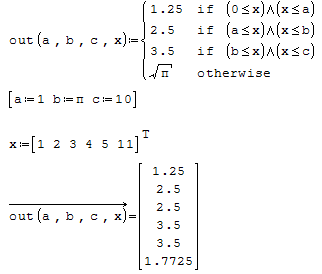

#7 Posted: 11/10/2021 10:33:54 AM
983 likes in 6866 posts.
I have several question relative to this image on the page.
Generalize algo style for infinite demands.

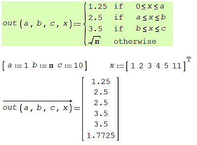

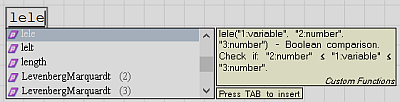

#8 Posted: 11/10/2021 11:12:41 AM
NDTM Amarasekera
NDTM Amarasekera
130 likes in 352 posts.
This way also, using lele function. Thank you Jean for the example.
