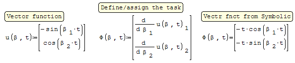

Hej i want to differentiate a unit vector like
I can only differentiate fx row 2 like this
Can anybody help, thanks

You can use the function vectorize(), a loop, or ranged indices... choose the one that fit your needs

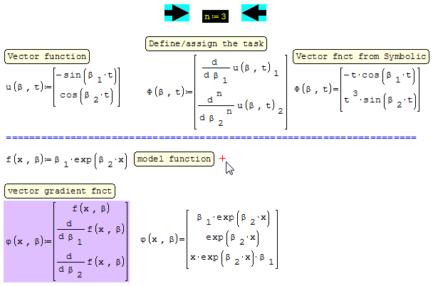

This is NOT unit vector. My understanding is that you want
a general procedure to differentiate a function vector.
This simple demo procedure is the core algorithm in Smath fitting functions
1. Genfit ,,,, 2. linfiCheby

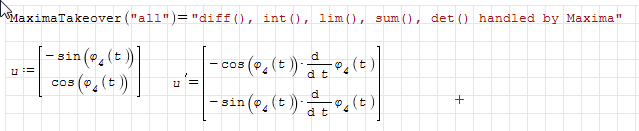

Here is another one. Maxima has generic vector-/matrix handling
