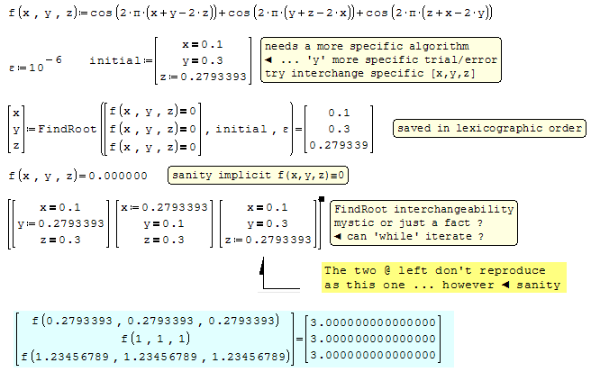

As overlord points, there are infinite solutions. Just like the better visual representation for z = f(x,y) is a surface in the 3D space, w = f(x,y,z) is a hypersurface in the 4D space. But we can't see that plot. So, here a plot of families of that 4D hypersurface, like a contour plot, but with surfaces.
About Dragilev method, I can't find my setup for 3D, and the expert there is Viacheslav (uni).
Plots4D.sm (111 KiB) downloaded 54 time(s).
Plots4D.pdf (393 KiB) downloaded 68 time(s).

Well, Fridel it's an expert too, thanks.
Joining above Dragilev and 4D methods.
Plots4D_DM3.sm (111 KiB) downloaded 59 time(s).
Plots4D_DM3.pdf (182 KiB) downloaded 61 time(s).
