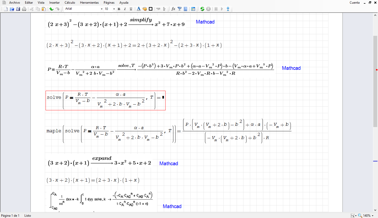

In mathcad there are: simplify, expand, substitute, etc.
When I solve an equation, I have to use "maple". Can this be done without using it?

I know the maple plugin has at least some of the functionality you're looking for. Also you'll want to check out the Maxima plugin as that's very useful for solving symbolic equations as well.

WroteHow can I do a symbolic resolution in SMath-Studio?
In Mathcad there are: simplify, expand, substitute, etc.
Most Mathcad command line work as well in Smath.

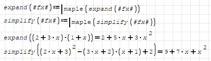

WroteHi Valentino. This is a way.
Mathcad to SMath Studio.sm (102 KiB) downloaded 161 time(s).
Alvaro thank you very much, your solution has worked very well for me. I have a question, you use commands like "Collect" and "Opt" but they don't appear in "all my functions"; The program executes the commands but it does not allow me to see their description or know what they are for, are they from a complement?

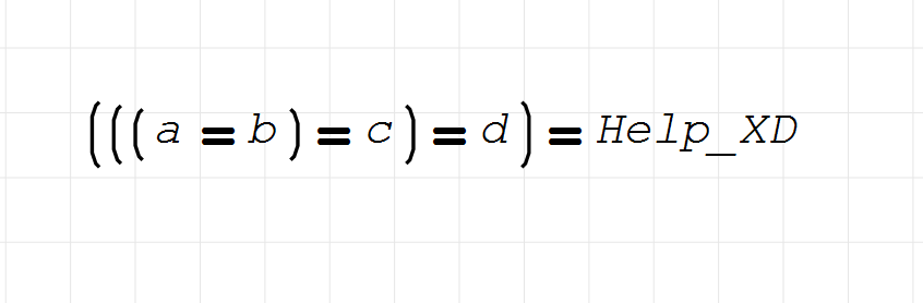

How did you put so many "boolean equals" without the parentheses being uncertain?
¿Cómo pusiste tantos "iguales booleanos" sin que los paréntesis sean inciertos?
Thank you
WroteHow did you put so many "boolean equals" without the parentheses
From an old Mathcad/Mathsoft contest.

Wrote...I have a question, you use commands like "Collect" and "Opt" but they don't appear in "all my functions"; ...
Opt = Symbolic or Opt = None means that you must to right click over an expression, and choose Optimization / Symbolic or None, not a command.
About collect and other expression they aren't from SMath, but from Maple plugin, which is Maple version 6. So, you must to learn something about it. Maplesoft online help could be very extended: Maple help but you can also read some good manuals like "Aprenda Maple 8 como si estuviera en primero" from Universidad de Navarra (you can google it, it's free). Just a notice: Maple V have several differences about how handle strings and some other things, so if you can't find a good short manual about Maple 6 try only up versions.

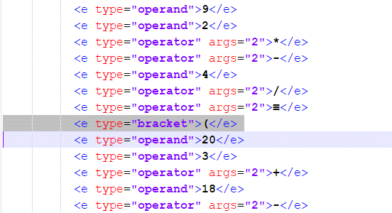

Wrote¿Cómo pusiste tantos "iguales booleanos" sin que los paréntesis sean inciertos?
With some hard work you can hack the SMath syntax: From https://en.smath.com/forum/yaf_postsm56111_Some-future-requests.aspx#post56111
HackingEqual.sm (3 KiB) downloaded 122 time(s).
