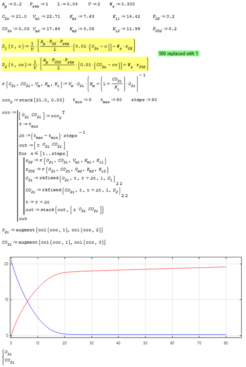

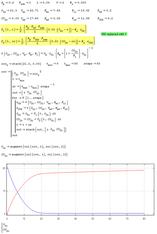

Now, sorry for bothering you again, I would like to have another little help.
To have the model properly working I need to add some other pieces, and I made some tentative to put these pieces is with some uhmmm "horrible" results.
Now, If you can give me feedback on what I have done on pages 2-3 would be lovely
I would like to understand if what I have done is totally wrong or if there are some "grammatical" errors.
So any Help is welcome!
Modeling respiration-transpiration FRA2.sm (46 KiB) downloaded 48 time(s).

Yes, in reality, that two DE was just a first step.
What I need to do is just a little bit more complex than what is written in the first paper, because there are a lot of things that have an influence on the mass transfer in a package.
So, what I'm trying to do is to add a piece at once.
Now, in the last file there are in oco 5 pieces.
[O.2i (oxygen in the package),
C.O2i (CO2 in the package),
m.pr (amount of water that permeate through the plastic film),
W.1 (weight loss of product due to the loss of water),
HR1 (humidity in the package]
Now, unfortunately, all these factors are correlated...and more are needed for describing all the system.
I'm trying to write in a very simple way what I would like to do on the smath file, and I hope it will be possible.
Honest, more I look at the sheet and more it seems a mess to me.
I need to find a way to make it more simple
Presentation1.pdf (107 KiB) downloaded 53 time(s).
Modeling respiration-transpiration in a modified atmosphere packaging system containing blueberry 2 (uni).pdf (83 KiB) downloaded 51 time(s).
Modeling respiration-transpiration in a modified atmosphere packaging system containing blueberry 2 (uni).sm (18 KiB) downloaded 52 time(s).
