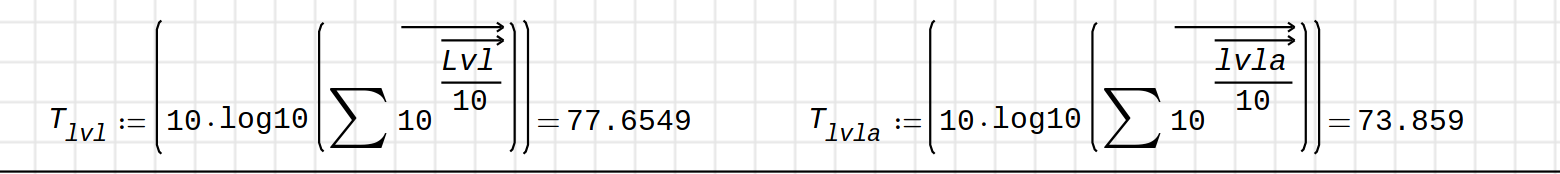

Hi All,
I am trying to work out the 'A' weighting values for sound levels, I have the calculation working, but I would like to simplify the total power levels, by either summation or a loop function. I know how to use summation, but cant get it to work on this.
[albumimg]1595[/albumimg]
acoustics 1.sm (17 KiB) downloaded 51 time(s).

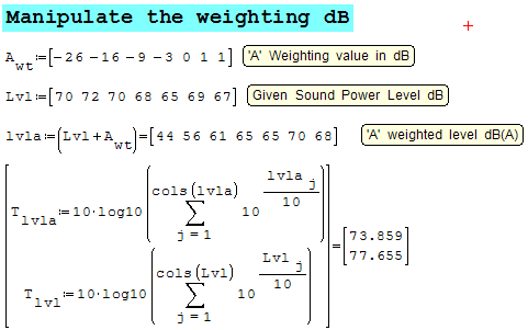

How's this? Using vectorize() function to apply operations to each element in a matrix.
Show Spoiler
acoustics_lyles.sm (14 KiB) downloaded 72 time(s).

Hi Alyles,
That was exactly what i was looking for thank you.
