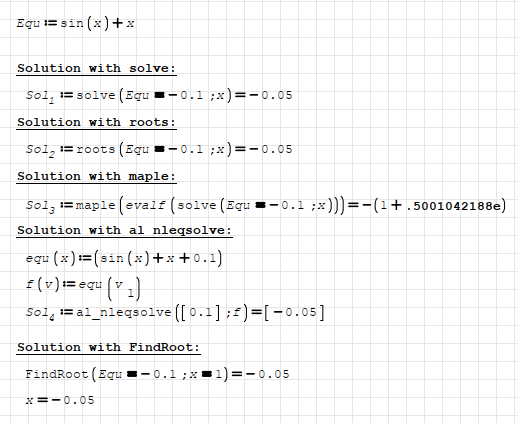

Hallo guys,
i have an simple qeustion:
How can i numerical solve an equation with a solver block like in mathcad.
An equation which is transzentent for example
for example:
sin(x) + x = Y --> solve for x
and how can i solve an equation when equation is not transzentent?
like in mathcad with a solver block area....?
thank you br Stefan
#2 Posted: 4/29/2022 6:19:37 AM
1403 likes in 1708 posts.
Various examples are possible.
Mathcad Block. FindRoot example.sm (4 KiB) downloaded 104 time(s).

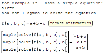

another question:
for example if i have a simple equation:
a+b=c
how can i symbolic solve the equation
so that a=c-b is the result.
If i use solve function all variables need to have a number
I simply want to symbolic solve the equation to a variable without using any numbers asigned to a variable
thank you,
br Stefan

Another question:
Stefan Müller 5/4/2022 7:30:00 AM
#10 Posted: 5/3/2022 11:45:50 AM
555 likes in 1333 posts.
There is maple and maxima plugins for symbolic calculations you asked for.
SMath's own symbolic engine is not capable as those two.

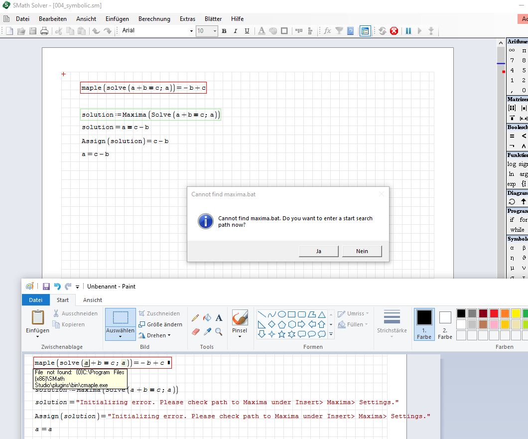

#13 Posted: 5/4/2022 6:14:37 AM
Stefan Müller
Stefan Müller
0 likes in 45 posts.
Thank you but i have a problem i downloaded the latest version
i downloaded maxima plugin and others but i do get a failure when opening your file see attached picture
There is a file missing:
cmaple.exe / maxima.bat missing
What can i do ?
however smath says maxima plugin is installed:
Thank you br Stefan
#14 Posted: 5/4/2022 6:42:10 AM
What can i do ?
Thank you br Stefan
It seems your mentioned firewall settings prevented proper installation of Maple plugin.
Usually SMath plugins are saved under this path in Windows 10.
C:\Users\/AppData/Roaming/SMath/extensions/plugins/
I can copy my plugins directory on Windows partition and upload it for you to download and copy/overwrite.
But it won't be a convenient way to install plugins. Set an exception to your firewall for SMath downloads.
Maxima is another subject, plugin seems installed but you will need Maxima software to make it work.
Latest version can be downloaded and installed from link below.
https://netix.dl.sourceforge.net/project/maxima/Maxima-Windows/5.46.0-Windows/maxima-5.46.0-win64.exe
You also have to set the path for Maxima.bat under Insert>Maxima control windows>Settings menu.
Click to enlarge
Stefan Müller 5/4/2022 7:58:00 AM

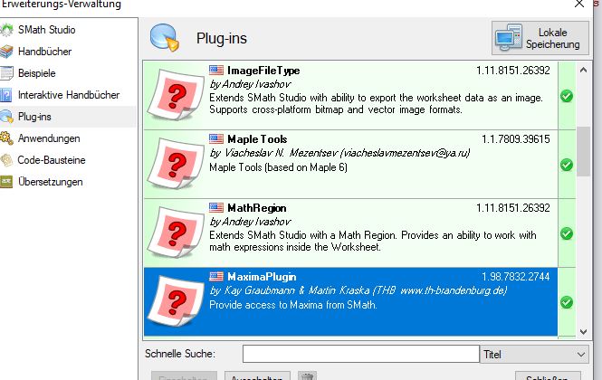

#19 Posted: 5/4/2022 7:54:19 AM
Stefan Müller
Stefan Müller
ok thank you but now im a little bit confused.
I searched maple plugin herer:
https://en.smath.com/list/plugins
but i cannot find the plugin
software needs cmaple.exe in order to work. Where do i find this?
Thank you br Stefan
#20 Posted: 5/4/2022 8:10:28 AM
https://smath.info:8443/!/#public/view/head/plugins/MapleTools/Resources
It is in cmaple.zip file on this page.
It is in also plugin.zip file I uploaded for you.
Stefan Müller 5/4/2022 8:39:00 AM
