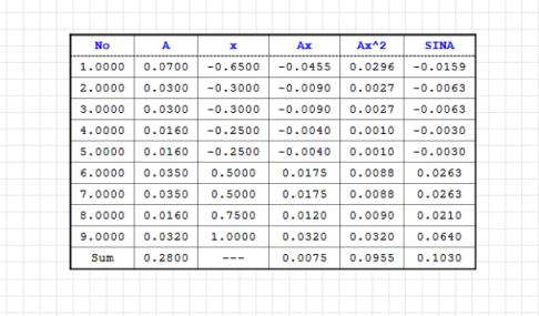

Something like this?
Tabla_Momentos.sm (57 KiB) downloaded 84 time(s).
Carlos
Carlos
Exactly what I was looking for! Thank you so much! This function is going to be really useful for me.

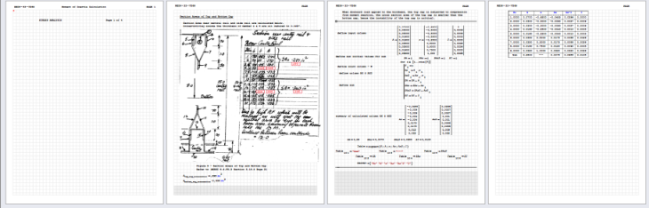

Stress Analysis-Table Region Failed.sm (152 KiB) downloaded 56 time(s).
Attached is the subjected worksheet. Please review.
Thanks again!
Chris

Hi Fedeghi:
Thank you so much for trying to help.
I deleted the first page. When the "red box" appeared, it took about 4 pages of content away. Only 2 pages are related to the table region, the rest of them were independent.
Stress Analysis-Moment of Inertia Calculation.sm (27 KiB) downloaded 53 time(s).
Here is the "table region" as an independent file. It worked fine until I inserted it into the main file.
Thank you!
Chris

Here is a version of the file in SS-7030 including a sheet that is visible from the file that failed
Stress Analysis-Moment of Inertia Calculation_V7030.sm (167 KiB) downloaded 56 time(s).
Carlos

Thank you Carlos!
There is supposed to be 2 more pages of data. I assume when the error happens it removed everything after it.
Anyways, I have re written everything and so far no issues.
Thanks again for your help!
Chris
