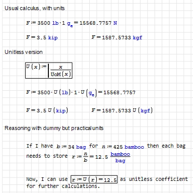

For me units have 2 purposes:
1. Getting quickly understandable numbers
2. Checking errors (unit consistency)
Hi. I agree. Here, a way to get that. Also, notice that you can use almost any other unicode symbol for U(x), or 'U(x), i.e. U in blue.
DummyUnits.sm (9 KiB) downloaded 71 time(s).

This is where Smath is great with the possibility to use any variable as a unit. I even sometimes define units such as "bag" or "bamboo"! And doing that without using an actual "unit" but only a variable, allows to bypass Smath's unit consistency check.
That's what I have exemplified ad noseum.
However identifying what bamboo means.
Per say: approximate/discretize a PDF ... explicit result.
Pretty easy to explicit sin(30)= rad/°
Engineers manage well non SI projects.

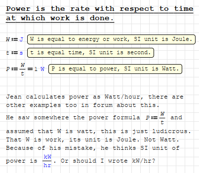

I find Jean's unitless calculations very very elegant and fascinating.
Problem is, his calculations are hard to read. Harder to understand, illogical to revise since they are bound to certain units.
Everything is everywhere, they are color racket and there is no heuristical walkthrough in his samples.
There are even some converting numbers, strain you to understand where they come from
Which those convert numbers would be redundant if he bothered to use embedded units.
Those numbers doesn't look not very elegant on page, and not knowing where they come from at first glance is not fascinating.
And sometimes that numbers tend to make serious mistakes, like that kW/hr pump power calculation of his.
Not even a typo, he divided 1hr (3600s) to g.e (9.8), found 367 and used it in that abomination.
I have never seen that kW/hr usage anywhere, but interestingly his pump power results have it.
It should even be kW, not even kW*hr. What will be benefit of pump electrical consumption calculation?
Everything that works, and is understandable, is good, very good!
Real problem is, some of his engineering calculations, especially unitless ones, have some serious mistakes.
Most of his viscosity related calculations are wrong due to his lack and denial of unit usage.
If he bothered and learned how to use units, he would see engineering is not just operations on given numbers.
Units and their relations are also very important to obtain correct answer at the end of some calculations.
