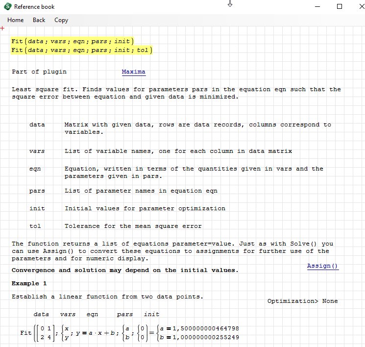

Is there any curve fitting function in Smath?
I mean using the defined points to find the function of these points!
Thanks a lot!

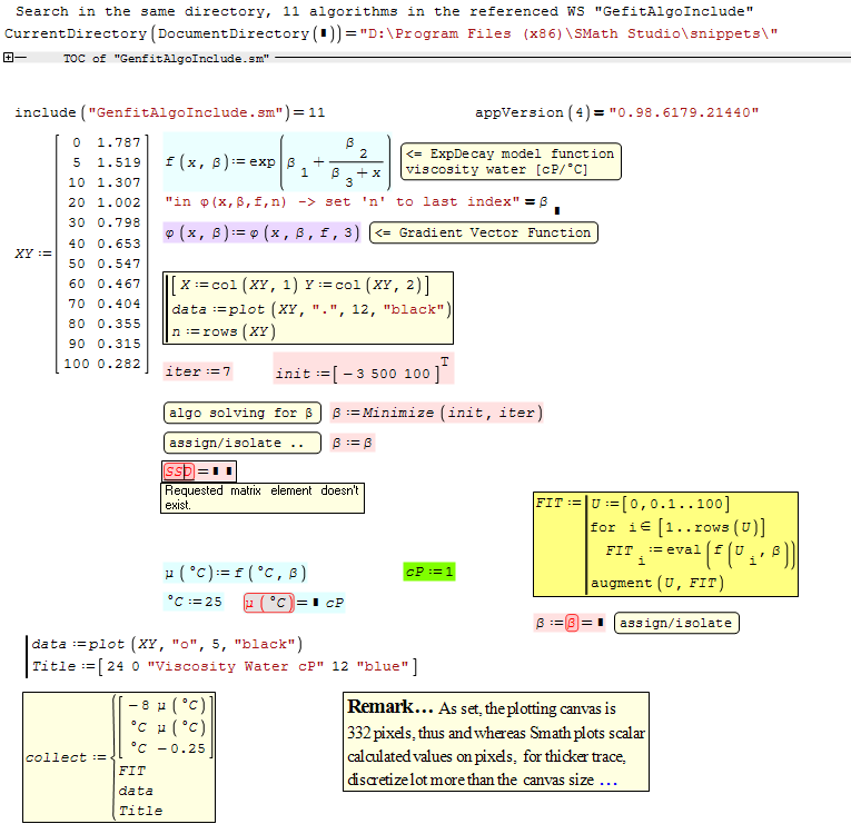

Hi Jean,
Thanks for your reply!
I tired the .sm file, but it doesn't work well. Meanwhile, the Genfit Algo Include.sm needs rename as GenfitAlgoInclude.sm.
I put the two .sm files in the same location, tSmath_error.pnghen I opened the Test Updated.sm, and pressed F9 to run....the error is shown in the picture.
The information of my Smath is Version 0.99
Looking forward to your feedback, thanks!

Maxima plugin has the Fit() function, see this post
In the interactive handbook, you find it in the Function Index page.

I tried the .sm file, but it doesn't work well.
You have detected a bug wrt your SS version, maybe earlier ones ?
Silent Smath Community ?
If you open the governing Conjugate Gradient ... it could be
the symbolic module has not been saved Symbolic, a common bug reported.
