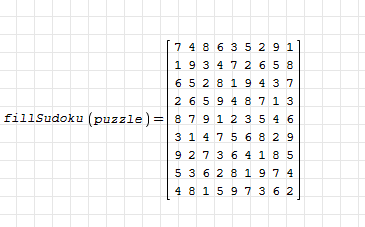

I have been trying to make this code work for two days.
Actually it is a C code which I am trying to implicate to SMath. C code is also included and runs perfectly.
In SMath, code works to a point actually. When I debug it I can see it can assign numbers, backtrack if there is no option.
So SMath code also seems legit but eventually the algorithm just stop working. No error no significant reason.
With different puzzles, code terminated at different places at middle of calculation.
I couldn't figure out what is wrong. Is it a bug or my coding is insufficient?
Any help should be appreciated.
Regards.
sudoku.sm (26 KiB) downloaded 83 time(s).
sudoku.7z (38 KiB) downloaded 58 time(s).

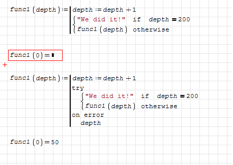

To better illustrate what I think is happening I've created the following worksheet. The first function definition is just a simple function that calls itself recursively until its 200th call at which point it exits. However, when run it experiences the same error as we see in the sudoku.sm. I rewrote the function using a try/on error and we see we only get to 50 iterations before it fails.

This looks to correlate to a depth of ~21 or 22 levels of recursion no matter the starting puzzle.
recursion.sm (4 KiB) downloaded 55 time(s).
What I understood considering your last messages, you think there is nothing significant wrong with the code itself. Problem is SMath handling of recursions.
So, it comes forward that is why I wouldn't be able to make an SMath Sudoku Solver with recursion.

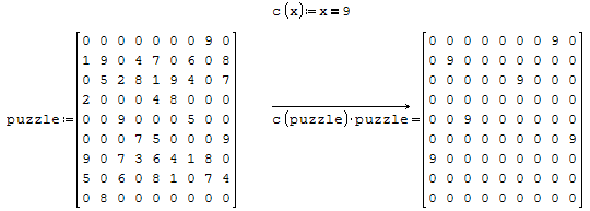

I remember this limitation was introduced some time ago to avoid unintentional hard crashes on wrong formed algorithms; considering that any recursive algorithm can be made iterative, you probably have to design it in another way or find a different code
