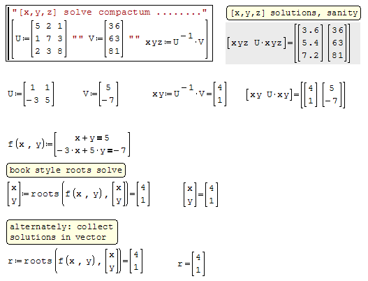

#2 Posted: 1/9/2020 7:56:09 AM
983 likes in 6866 posts.
Hi, I am trying to solve this equation
... like this, simply ... two most direct methods.
Not a case of solve(2), solve(4).
There are more methods than in the attached.
Observe the so much from so little
Solve [x,y,z] Compactum.sm (92 KiB) downloaded 70 time(s).
#3 Posted: 1/9/2020 7:59:18 AM
115 likes in 329 posts.
"solve" is only for one-variable functions. You can use "FindRoot" or "roots" as in the attached example solve.sm (6 KiB) downloaded 79 time(s).
