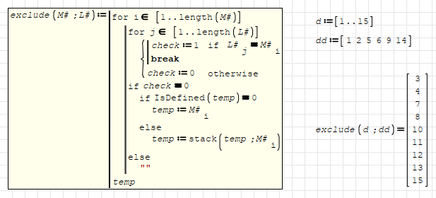

In addition to sergio's answer, you can use an custom exclude function.
It will remove substances of a L# list from master M# list.
exclude.sm (5 KiB) downloaded 74 time(s).
