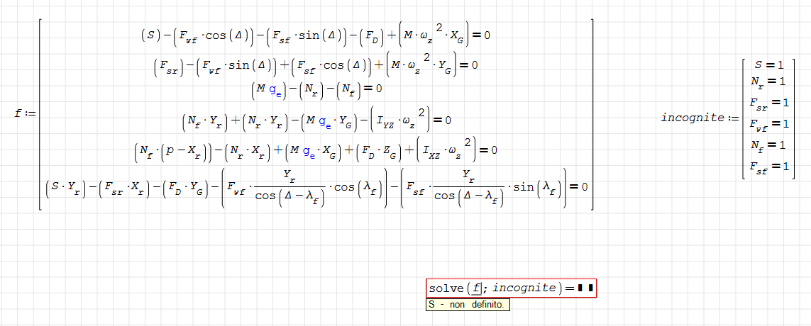

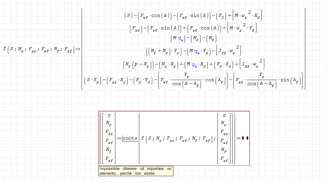

Hi to everyone
I am having difficulty solving a linear system like in the picture.
the error says:"impossible to get or set an item because it does not exist"
does anyone know where the error can be and how to solve this problem?
Thanks in advance
#2 Posted: 11/5/2019 3:08:12 PM
115 likes in 329 posts.
"roots" does not work with the units. You must adimensionare equations, or you can try the other features present in the plugin (eg "FindRoot" present "Nonlinear solvers" plugin)

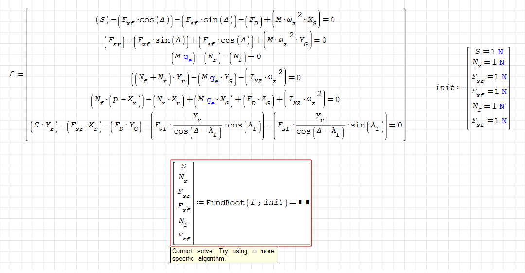

#3 Posted: 11/5/2019 3:52:23 PM
Ale16595
Ale16595
0 likes in 35 posts.
I tried another function but it still gives me an error...

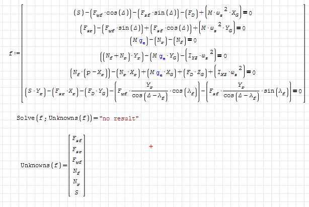

Equations 3 and 4 probably demand different values for N.r+N.f So there is no solution.
If the system has a solution, the function Solve() from Maxima plugin might find it.
