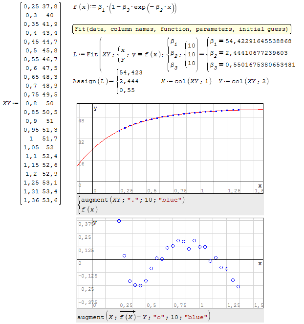

#3 Posted: 3/23/2018 7:17:02 AM
1230 likes in 2155 posts.
Demo for usage of the Fit() function (Maxima)
Genfit%20Thermal%20Insulation_Kr.sm (9 KiB) downloaded 94 time(s).
