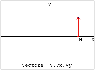

Kinematics of a Moving Point
Davide Carpi 11/12/2012 7:19:00 AM
