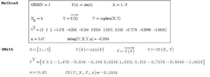

Hi Jean. There are not to much shadow in that small code. It's just the implementation of the traditional spline interpolation. In SMath there are not, or I can't found, the function cspline. The interpolation with cinterp in SMath evaluates the vector V each time that you call it, it's always better to have V=cspline(X,Y) and then call interp(V,X,Y,x). Finally, I want to implement an adaptive step size for the intervals in X. But first I see very convenient to have vectorization and plotting issues solved.
CS only do what mathcad's cspline do:

CS only does what Mathcad's cspline does:
1. You have a good point, but invalid: cinterp(X,Y,x) works faster than Mathcad [I tested long time ago].

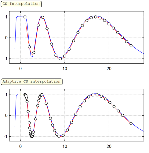

CSplines with adaptive steps. Same issues, but now can use zero with units, at least in the adaptive case.
adapt cspline test.sm (83 KiB) downloaded 110 time(s).

Updated (Now it works again). Revised because the new develop of interpolation funcitons by Viacheslav at https://en.smath.com/forum/yaf_postsm75020_ODE-Solvers.aspx#post75020
This worksheet is about adaptive csplines and differentiation and integration of the splines.
