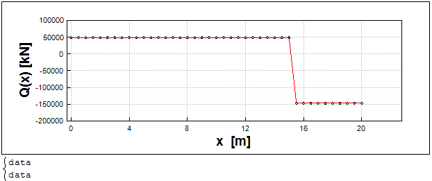

I'm new to smart studio and I'm trying to plot the graph for this function of a bi-supported beam but I can't
whyplot.sm (7 KiB) downloaded 66 time(s).

Something like that. The X-Y Plot plugin doesn't have advanced capabilities for working with units.
Unlike Mathcad, we have only one field for describing the graph. For this reason, we can only learn about the X variable from this description. For this, it must be undefined. The component looks for undefined variables in the expression and uses them to determine how to plot a graph. If you define the variable x, then the component will not understand how to plot the graph. The tilde sign (~) helps him with this as an analogue of the range variable in Mathcad.

You have an incorrectly written expression:
Click to enlarge

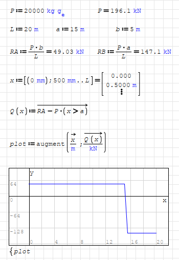

We usually plot the graph like this:
Click to enlarge
Zap units for the plot.
whyplot (else).sm (13 KiB) downloaded 72 time(s).
Same approach with embedded 2D plot.
This would be awesome if 2D plot supports tilde sign (~) ranges.
