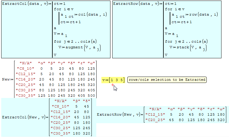

#7 Posted: 10/20/2018 11:31:41 AM
115 likes in 329 posts.
Yes. For example in the two ways shown here
Concrete_02.sm (9 KiB) downloaded 149 time(s).
yuriy1996 10/20/2018 11:46:00 AM
