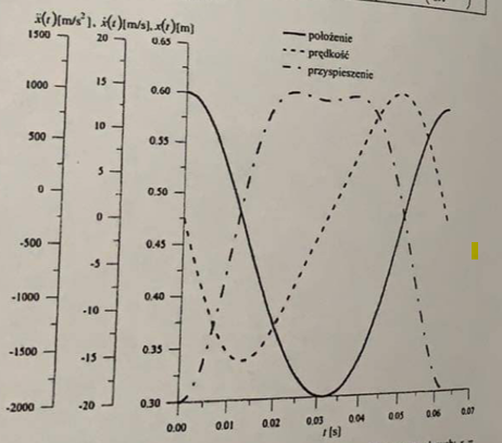

Is it possible to make such a chart with three Y axes on a single chart?
something like this
https://ibb.co/JcRn2B9

In case you want to have more than one Y value axis, in"XY Plugin" you can set two different Y axis scales: some traces will refer to Y1, some to Y2
I think that there is not "out of the box" tool to have three or more Y axis.

It is not possible to show three separate y-axis as fedeghi already told.
However, you can show three function on a single chart with sys().

You can have as many as you want of fake style like the image.
Create Y's as image and slide close to the plot.
You can do lot more Professional ... associate each graph with Nodes Labels.
Cheers ... Jean.

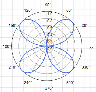

Using X-Y Plot Region, you can simulate your graph with any number of axes, but needs some programming like in this example.
XYPlot. Linear polar.sm (61 KiB) downloaded 83 time(s).

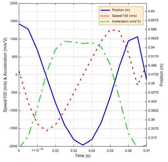

It is possible to use a graph with 2 Y-axes as shown in the image.
Carlos

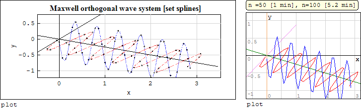

... as many as you want horizontal/vertical,
disposed inner wrt the Quick Plot
otherwise outside X_Y past build-in default 2.
Utilities XY Label Graph MORE.sm (35 KiB) downloaded 88 time(s).
... from this factory demo.
Utilities XY Label Graph Y.sm (22 KiB) downloaded 84 time(s).

983 likes in 6866 posts.
... for whatever end use, add margins/calipers.
Utilities XY Label Graph Y factory.sm (41 KiB) downloaded 96 time(s).
