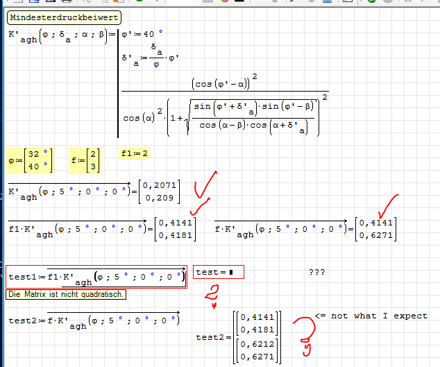

Please have a look a the following example:
The first two results look good.
But why assigning the formula to a variable not work?
And the result test2 doesn't look right, does it?
vectorize.sm (11 KiB) downloaded 113 time(s).
Thanks for your help!

WroteResult is same as if done by hand.
Probably I don't really understand how vectorize works.
If _I_ would do it by hand,
- I take the first element of "f" and the first element of "phi" (the two vectors in the expression)
- I calculate the result and put it as first element in a vector
- I continue with the the second elements ...
- I would obtain a two-element-vector
that's what I get by evaluating the expression
vectorize(f*K.agh(φ,5*'°,0*'°,0*'°
I don't understand why it's a different result if this expression is assigned to a variable.
If the first factor within vectorize is a scalar, the error "Matrix must be square." is shown. But again only if the expression is assigned to a variable.
Everything works fine with functions without the line command. (But it's not possible to to do it without line in every case.)
vectorize2.sm (15 KiB) downloaded 98 time(s).

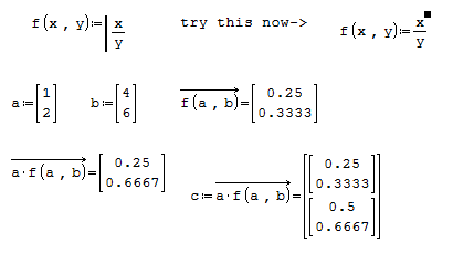

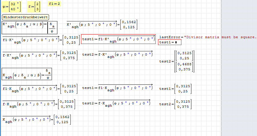

The problem is in the function definition with or without line environment (as you already noted), and using the function call inside vectorize. See the picture please.
It might be a bit peculiar (maybe a bug) but one should be careful about it. It is advisable to assign the values to variables first and then to use vectorize (not to use function calls with vector arguments inside vectorize). Anyway, your gave an example where one can be easily confused.

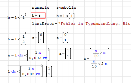

WroteFound another strange behavior (as I think):
Shouldn't vectorize handle 1-element vectors like any other with more elements?
It should. I think I can fix it, thank you
As for the initial problem, I tend to consider it a bug/issue, simply because what you get when the function is on the left side of an evaluation is not what you get when the function is on the right side of an assignment.

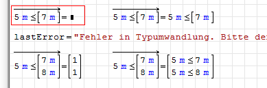

#8 Posted: 4/24/2017 12:58:15 PM
Vectorize operator operates on the RHS of an equation !
Example [1] is oK
Example [2] would not support the RHS of different unit dimensions [m, km ...]
"type conversion not supported".
Example [1] is oK

#11 Posted: 4/25/2017 12:45:14 PM
I just mentioned, that vectorize cannot handle vectors with the length 1.
And I think it should.
Or the other way round: Why do you think, it is correct the way it works at current state.
And my previous post was a reply to your comment to show that RHS or not doesn't matter and that unit dimensions also don't affect "my" problem at all.
