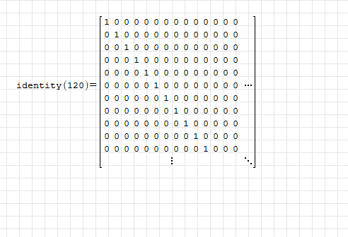

#1 Posted: 2/24/2018 2:08:08 PM
I am showing the content of a numerical 6x6 matrix but the last column is not displayed, I can index into the last column so it is clearly just the rendering. Does anyone know of a way to get the 6th column to show?

#3 Posted: 2/24/2018 3:31:06 PM
The content might be hidden if the matrix is too large (number of elements or width/height)
Check if there are ellipsis displayed on the left/bottom edges and drag them aroud to display the hidden content.
Otherwise as suggested above attach the file that doesn't work for you

#4 Posted: 3/3/2018 9:26:37 AM
Thanks for replies - it does show an ellipsis and dragging has uncovered the hidden column. Problem solved!
#5 Posted: 3/3/2018 11:18:45 AM
WroteThanks for replies - it does show an ellipsis and dragging has uncovered the hidden column. Problem solved!
Problem solved <= Answer Problem NOT solved
The "ellipsis" feature [Smath 6179 ...] is convenient to display limited check from long
vector(s)/matrix ... however: can't be used to collect the entire result [it collect
what is displayed only]. To collect the entire result ... like this:
1. result
2. [result] from matrix drop down menu 1 row by 1 col
3. [result]= set decimal places, F9 to calculate
4. @ this point, you can export the entire vector/matrix.
