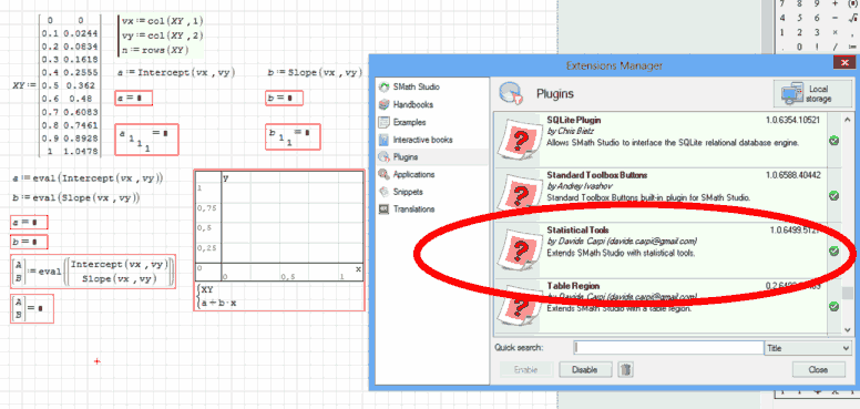

Hello Jean,
something to check in the symbolic engine; change the optimization of a:Intercept(vx,vy) from symbolic to numeric

#3 Posted: 12/7/2017 2:03:58 PM
983 likes in 6866 posts.
Thanks Davide ... works fine Numeric !

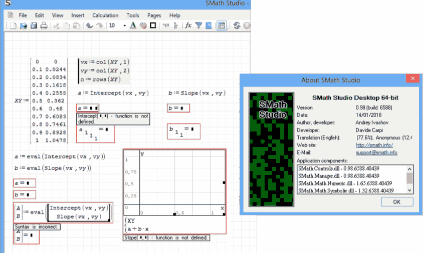

#6 Posted: 1/15/2018 8:29:06 PM
CBG
CBG
77 likes in 312 posts.
I get these errors when I run the file:
Carlos

#8 Posted: 1/16/2018 2:02:49 AM
CBG
CBG
Thanks Jean, but I get the same error.
Is your Smath studio 32-bit?
My Smath Studio 64-bit, does not recognize the
functions of Interception and slope.
Carlos
#9 Posted: 1/16/2018 3:37:52 AM
NDTM Amarasekera
NDTM Amarasekera
130 likes in 352 posts.
Hello!
Jean's example also works in my laptop (Win 10, 64 bit) with latest SS 6588 dated 14/01/2018.
The Functions are in Statistical Tools Plugin.
#10 Posted: 1/16/2018 5:36:02 AM
1417 likes in 2873 posts.
Carlos, do you have statistical tools plug-in installed and enabled?
#11 Posted: 1/16/2018 7:04:34 PM
CBG
CBG
Quote
Yes I have it.
Carlos
#12 Posted: 1/17/2018 4:57:25 AM
I see, trying to figure out what's happening here
