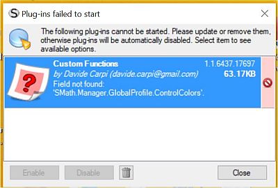

I am experiencing problem in installing CustomFunctions Plugin in SS 6520 (07/11/2017).
Even some items {(such as cases(), abs()}in the Function Index of Reference book have problems.
I am using Win 10 64 bit latest update.
Pl test the attached example.
Small Dams Flood Routing Ex-Program Method-Original-Simple3.sm (863 KiB) downloaded 86 time(s).

#2 Posted: 11/8/2017 9:37:35 AM
325 likes and 1 dislikes in 2052 posts.
Confirmed as well,

#3 Posted: 11/8/2017 3:49:41 PM
1418 likes in 2873 posts.
Thank you, I'll fix it ASAP. As usual please be patient and keep reporting issues
