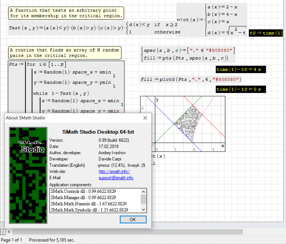

Jean,
It does not work in 6622.
In Graph: (does not display any graph)
Error: Random()= Function is not defined.
Thanks,
Basile
#3 Posted: 2/18/2018 4:32:39 PM
2276 likes in 3759 posts.
Hello [USERLINK]Basile[/USERLINK].
It does work on my copy of 0.99.6622:
Tried different locales - everything seems ok.
Random(..) function is from Statistical Tools plug-in. Please check if this plug-in available on your PC.
#4 Posted: 2/18/2018 4:49:32 PM
Basile
Basile
8 likes in 172 posts.
SMath-01.PNGHello Andrey,
Attached please find a print screen.
Am I doing something wreong?
Thank you,
Basile

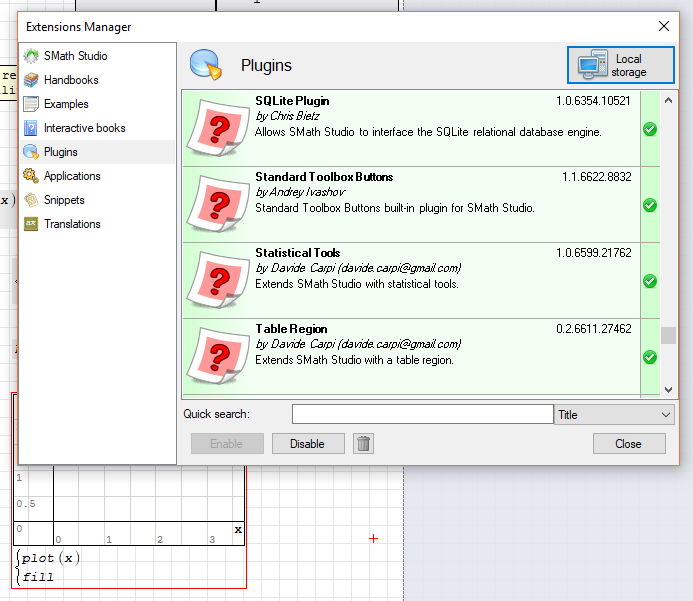

#6 Posted: 2/18/2018 5:05:33 PM
Basile
Basile
SMath-02.PNGIt looks that it is...
#7 Posted: 2/18/2018 5:21:15 PM
Please could you check what plug-in handles Random function in your case?
Also please try to test Random function... will it work in most usual scenarios on your environment?

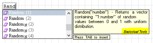

#8 Posted: 2/18/2018 6:45:09 PM
Basile
Basile
SMath-03.PNGHere it is...
And how do you want me to test the Rand, please?

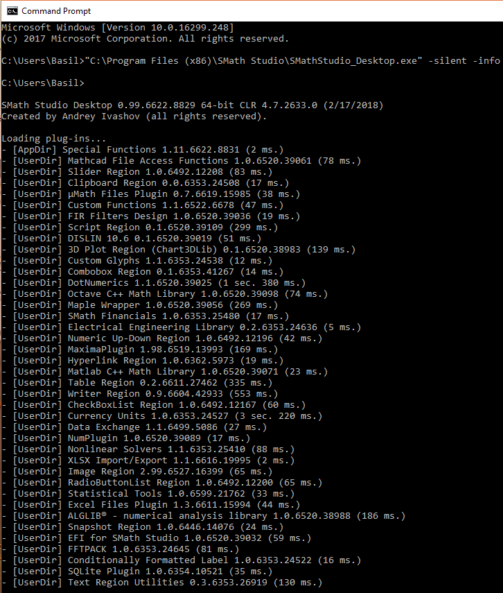

Not sure, but may be this is because of sort order of plug-ins or some additional plug-in which breaks the logic...
Please could you execute the following in command line? (path to SMathStudio_Desktop.exe may differ on your PC)
"C:\Program Files (x86)\SMath Studio\SMathStudio_Desktop.exe" -silent -info
I would like to see the output of this command in order to try to reproduce this on my environment.

#13 Posted: 2/19/2018 10:09:18 PM
Basile
Basile
SMath-05.PNGHere it is:
#14 Posted: 2/19/2018 10:11:22 PM
Basile
Basile
#15 Posted: 2/21/2018 3:59:05 AM
Thank you very much! Now I have everything to try reproducing this issue.
