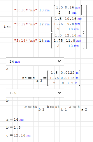

Hello.I have data. I want choosing "a", get only relevant values to choose "b" and output value "c" (if a=10mm; for b there should be options only 1.5 and 2; e.g. selected b=2; means c=8.0mm)
File not found.
Question 1: How can I do that?
Question 2: Choosing from a list of values "a" with this assignment of the matrix values are repeated. How to avoid it?
File not found.
#2 Posted: 7/17/2022 4:42:53 PM
555 likes in 1333 posts.
You may need a temp data derived from first combobox selection.
And use that new data at second combobox.
Here is your both questions answered.
combobox_question.sm (8 KiB) downloaded 68 time(s).

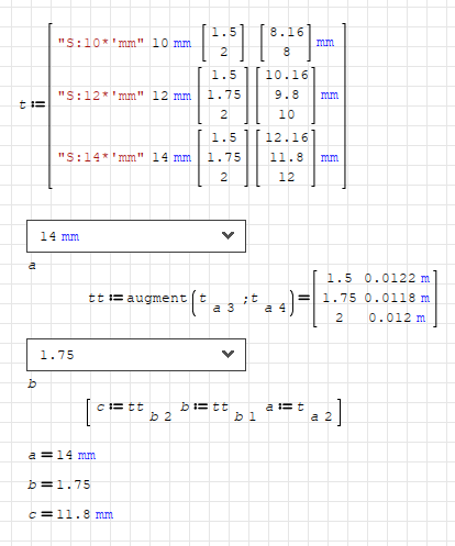

#3 Posted: 7/17/2022 5:28:21 PM
You can reduce data matrix like this too.
combobox_question.sm (8 KiB) downloaded 79 time(s).
#4 Posted: 7/18/2022 2:42:50 PM
Prmtv
Prmtv
0 likes in 49 posts.
Exactly what is needed. Thank you!
