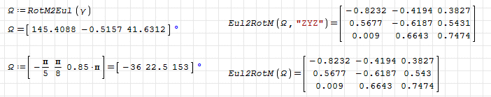

Hi Ber7. Thanks for the angles, which gives this beatifull view point!

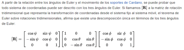

Using SMath convention for axis it's very difficult to me, and also add the fact that in Latin America we use this as Euler angles:
https://es.wikipedia.org/wiki/%C3%81ngulos_de_Euler
In the attached, I can invert emulating the matlab robots toolbox's rotm2eul.m function, but notice that I need to swap the product order to get the same matrix with those angles that I obtain first.
So, I don't sure now if we are doing the rotations ok taking Ω1*Ω2*Ω3 or, for SMath, the correct order is Ω3*Ω2*Ω1, and this swap is the math meaning for "left coordinate system".
rotm2eul.sm (83 KiB) downloaded 105 time(s).

#2 Posted: 10/10/2018 2:53:22 PM
WroteSo, I'm not sure now if we are doing the rotations ok taking Ω1*Ω2*Ω3 or, for SMath, the correct order is Ω3*Ω2*Ω1, and this swap is the math meaning for "left coordinate system".
Euler traditional [Roll, Pitch, Yaw] is not commutative once angles are defined.
Some 3D solids will show convenient in any of the possible 3! = 6 commutative.
Rotate Euler NOT Commutative.sm (16 KiB) downloaded 107 time(s).
