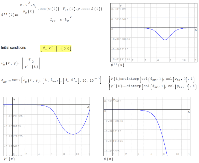

Hi, sorry if I bother you again. I'm trying to integrate a function, the function in question is psi''(t) in order to derive psi'(t).
I tried using Simpson and Romberg's recursive methods, but without getting a solution.
Where am I wrong?
PROJECT.sm (69 KiB) downloaded 61 time(s).
#32 Posted: 12/28/2019 9:59:18 PM
983 likes in 6866 posts.
You have phi in your document ... psi is a built-in function.
So, if phi''(t) is the 2nd derivative ... then the derivative
is simply the integral. To expedite fast: done discrete.
If you have questions: please re-post this document.
Cheers ... Jean.
PROJECT [1].sm (30 KiB) downloaded 56 time(s).

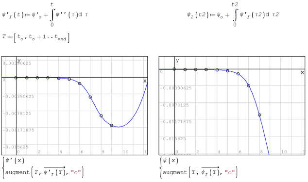

#33 Posted: 12/28/2019 11:19:45 PM
.... in fact you have PSI''(t).
Maple does not find an explicit integral.
PROJECT [1].sm (21 KiB) downloaded 60 time(s).
#34 Posted: 12/29/2019 9:18:44 AM
... lot more maths in there.
PROJECT [1].sm (44 KiB) downloaded 43 time(s).
Where am I wrong?
Hi. You can use any Runge Kutta solver for integration.
Also, you can use SMath int procedure, but it's very (very) slow:
For the theory, remember that you can integrate (with definite integrals) both sides of an equation and get an equality too, which don't work with derivatives.
PROJECT.sm (74 KiB) downloaded 64 time(s).

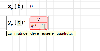

Hi, I have calculated the function psi '(t) through dn_GearsBDF.
But now I can't calculate the ratio in the picture.
The error says, "The matrix must be square"
PROJECT.sm (57 KiB) downloaded 50 time(s).
#37 Posted: 12/29/2019 2:19:55 PM
Result from numerical ODE solvers is a data set.
Generate an interpolation scalar to 'x' ... then plot.
@ the end of the document ... more questions: -this one.
PROJECT (1).sm (74 KiB) downloaded 67 time(s).
