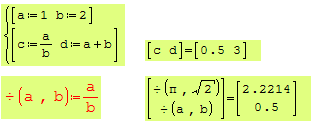

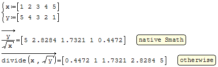

WroteIs there any way to present division on the same line and not as a fraction ?
Answer is NO, Smath does not have native ÷ operator
More productive from infix algo style utilities,
for infinite in-situ command line.
infix Divide.sm (3 KiB) downloaded 71 time(s).
