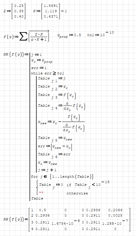

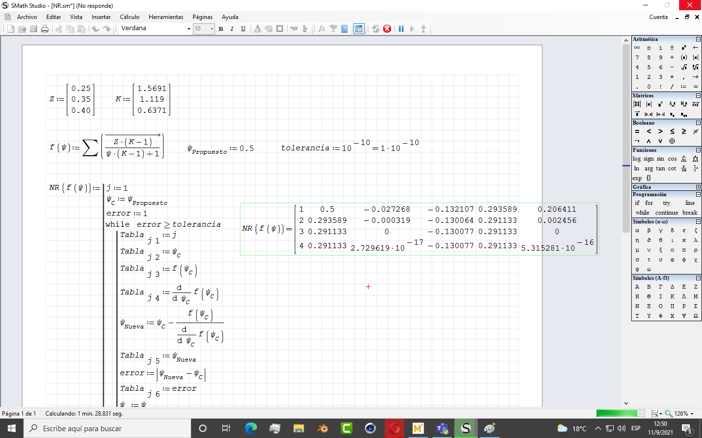

How can I do this loop while?
what am I doing wrong?

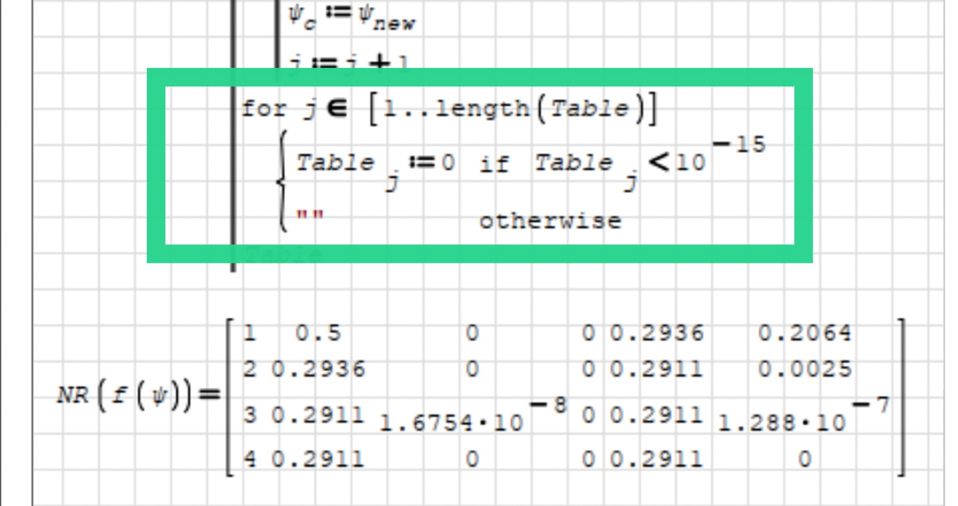

I think it already came out, but how do I make the numbers that are almost 0 not appear as 2.72 * 10 ^ -17?
#3 Posted: 9/11/2021 3:23:39 PM
554 likes in 1333 posts.
Add a check for every element if they are lower than something.
And if they are, make them zero.
what function does this have?
Thank you so much

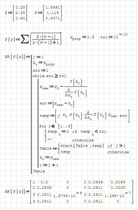

#5 Posted: 9/11/2021 4:09:46 PM
That is cases(), it is in Custom Functions plugin.
I would prefer to write your algorithm like attached.
It is just my preference by the way.
NR_r1.sm (9 KiB) downloaded 45 time(s).
