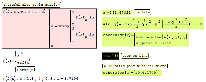

Interesting the implicit/recursive discrete solver.
Few more techniques/tools in these two Smath documents.
Contour SOLVE [user].sm (46 KiB) downloaded 97 time(s).
Contour SOLVE [at(2)].sm (174 KiB) downloaded 100 time(s).

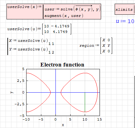

#2 Posted: 6/28/2018 8:42:30 AM
983 likes in 6866 posts.
Few more techniques/tools in this Smath document.
... lobes added
Contour SOLVE [user].sm (61 KiB) downloaded 96 time(s).

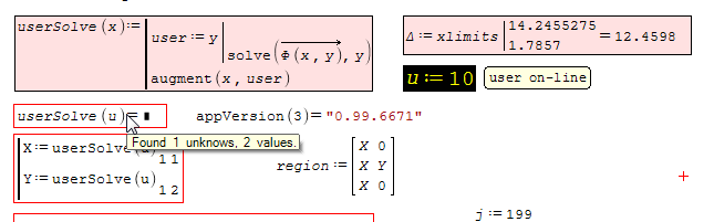

Hello Jean,
I just removed at(). Is this all right?
#6 Posted: 6/28/2018 8:23:00 PM
Hello Jean,

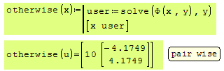

For sure, more than correct as your solve(,,) gets pair wise solutions.
Yes, the lobe is symmetric around the 0 datum.
#7 Posted: 6/28/2018 9:08:22 PM
... now I get pair wise solutions. But not augment !
