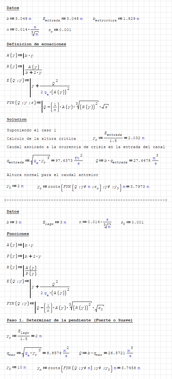

But the programming is the same in Smath? I mean, for example the FYN or root function still works?

But the programming is the same in Smath ?
I mean, for example the FYN or root function still works ?
Smath has many solvers. FYN from implicit roots(,,,).
roots will solve on the canvas [MACH number]
calculo Direct Code.sm (20 KiB) downloaded 82 time(s).

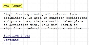

Maths eval(,) TEST.sm (19 KiB) downloaded 68 time(s).

eval(,) applies to parse result as a numeric entity.
In simple words, the kernel is a vector of calculated from what to calculate.
In this example, the last that will be calculated is eval([R G B])
It gains 1 min [3/4].
Cheers ... Jean.
Pattern Etoile Magic [Short].sm (81 KiB) downloaded 69 time(s).

Is there a reason why Dy is within in eval()?
eval() makes computations faster most of time.
Very minor times, may have no effect or slows the calculation.
It would be wise to choose where and when to use it.

  • eval() for faster calculations
