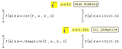

1. as well, you can recast the function name.
That's what I meant by recast, last page of the attached.
Cheers ... Jean.
Integrate AdaptiveRombergKernel FIRST Tool.sm (152 KiB) downloaded 70 time(s).
