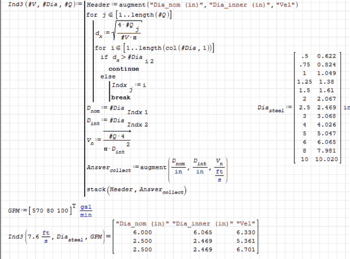

Here is a solution
PipeVel_CBG.sm (8 KiB) downloaded 81 time(s).

Muchas gracias Carlos. Lo que no podia ver es la indice else --> index.j:1 Handaba pensando en algo similar para retener el numro viejo, pero nada se me vino a la mente.

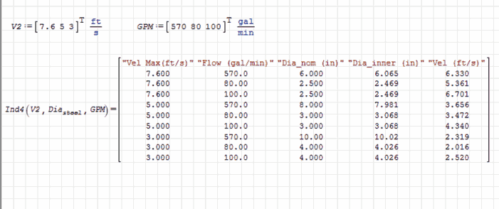

Ruben: A slightly more complicated algorithm, which supports several speeds and several flows.
PipeVel_CBG_R1.sm (14 KiB) downloaded 79 time(s).
Carlos

Interesting. I was looking at modifying your other code ... this is better inspiration.
I'm looking at sizing pipe at low flow, then calculate velocity, fixed pipe dia, at a higher flow. With your original code, I set this up in two steps to look at VFD driven system.
