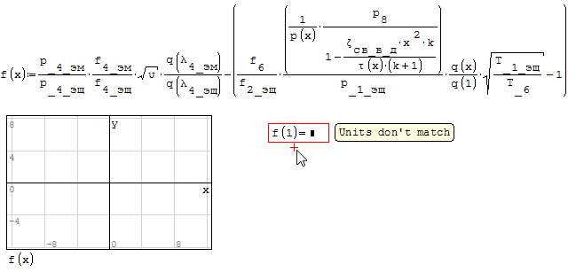

Who has faced such a problem, how can it be solved?
Project from below
Poverochnyjj raschjot ehzhektora.sm (84 KiB) downloaded 49 time(s).
#2 Posted: 2/12/2020 12:07:47 PM
983 likes in 6866 posts.
"result above max ..." has no pertinent meaning in your project.
If you attempt "roots" on the numerator only ... "Units don't match"
No need to go further ... zap the units in the project.

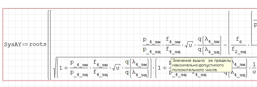

I made a mistake, there should be a solve function, in this place the same error
#4 Posted: 2/12/2020 2:57:49 PM
Same answer: Units don't match.
How can you solve what you can't plot or evaluate ?

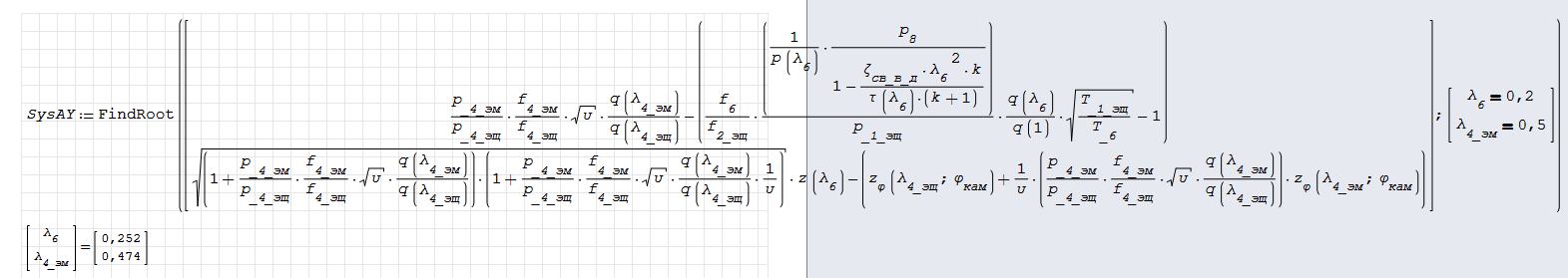

You can use the function FindRoot() from the Nonlinear Solvers plugin. The function automatically assigns the solution to the variables.
Единицы измерения здесь не при чем.

why do you use 0.2 and 0.5?

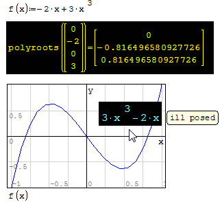

Always avoid ill posed polynomials.
