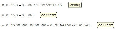

A CAS like Smath and others do not know if
0.123 is exactly = 0.123000000000000
I'm not aware of such an option in Smath

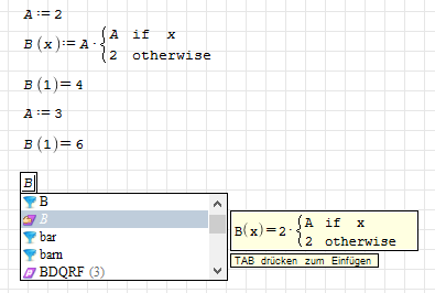

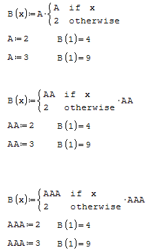

Another example:
The first A is replaced by its value, the second is not.
Not really intuitive or obvious, in my opinion.

#30 Posted: 5/3/2018 12:06:00 PM
983 likes in 6866 posts.
The best is to apply to a project and make it work.

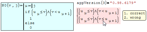

#31 Posted: 5/3/2018 1:02:11 PM
1417 likes in 2873 posts.
I'm too to not create confusion, however some features are tied to this feature; by removing it:
  • any argument will be preprocessed by smath; this means f.e. that if you place a definition, this will be evaluated despite the condition is met or not (like in if function)
  • the protection against assignments won't work anymore
  • won't be possible anymore to use functions like error()
(you will be able do them using line, though)
