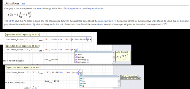

Can't reproduce. J/(kg*K) works. Paste 'J/{'kg*'K} to the square placeholder to the right of the unit when the region has focus.

Can't reproduce either "Units don't match",
because there is NO heat capacity unit in Smath.
Peter J Francis 8/2/2017 5:18:00 AM

You just have to change the units.

You are all correct (I knew the answer was going to be obvious ) , pasting in the units J/kg K works fine
Its just that Gy/K seems an odd default unit
