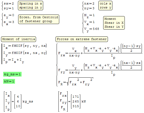

Since updating to Version 0.99.6671 (07 April 2018)
Several functions now return a "Cannot Calculate" error.
Any thoughts?

seems the problem is in matrix(0;#) (probably related with this), not sure if intentional or not.
Clear(r#) does the job BTW.

Just remove first line from fMOIF(s#,n1#,n2#) definition:
r#:matrix(0,n1#)
Why it was added? It does nothing for further calculation. What is a reason for it?
It is not a first time when I see code like matrix(0,0) and actually I do not understand what is it for... SMath Studio never had a possibility to generate a matrix of zero elements.

I don't know why the topic starter did it. He seems to allocate a matrix with no rows and then uses linear indexing.
Initializing matrices with no rows or columns is required for subsequent build-up of the contents using stack or augment in a loop.
See Handbuch page 130/131 for examples.
Now that implicit loops are available, this type of generating matrices may loose popularity. Yet initializing with an empty matrix is a safe way to enable assignment to elements (as using Clear() would be).

I used matrix(0,0) in this instance to make sure that r# is "clear". Now that I can use the clear() function I don't need to do this. However, I do use matrix(0,0) in other functions in order to "stack" or "augment" other matrices into the (0,0) matrix. Which is what Martin has described.
So will matrix(0,0) return and error in all cases now? If yes, what is the best way to build up a matrix that starts with nothing? I use this in other functions and I believe is also utilized in Martin's beam calculation snippet (great snippet by the way).

This is because in GetMax you are trying to build a matrix on x1# (that seems to be a variable named x#, this triggers the error)
Use Clear(x1#) or don't pass the second argument (why was needed?)
