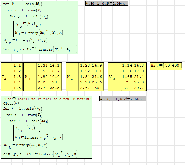

In the above attachments, I have illustrated two variants of a triple interpolation method, imagined by me. Each of the two examples contains the interpolation algorithm applied twice. The difference between the two examples is only the fact that in one of them, the two different applications of the same algorithm have been reversed. As you can see, there is an error in Attachment 1, while in Attachment 2, this error no longer exists. The question is, why two different applications of this algorithm in the same file lead to different results? In order to be able to quickly verify the intrinsic correctness of the algorithm, we can make the variable lb = 1, and the results of the calculations will be found properly, directly in the data matrices. Along with one of the algorithm applications, there is also an image with the variable assignment scheme and the correspondence of the rows and columns of the different matrices involved in calculating the algorithm design. The algorithm of this triple interpolation was designed on an older version of a SMath Studio Portable, but the error still persists in portable 98.6484, which I downloaded today from the Internet. I'm waiting for some thoughts about the probable causes of the problem, but I do not exclude suggestions for other algorithms to solve triple linear interpolation problems in SMath. I mention that the phenomenon presented here does not manifest in MathCAD14, no matter how many times I apply the algorithm imagined by me during the same file.
All the best.
Post scriptum: I found out after posting that I misplaced the subject, which actually had to be placed at the "Question" sub-forum. I'm sorry, and I'm asking the moderator to move the subject to the right place.

The issue in Example 1 is simply that in the 2nd loop you are overwriting data in the existing matrix M, therefore the size of this matrix is not the one you expected (is the initial size because the loop in the second application is shorter than the first, 4 vs 8 elements); to avoid this call a Clear(M) before using M in the second loop (alternatively you can call even M:matrix(0,0))

@Davide Carpi: On the two examples we can make any mathematical analysis we want. But I have mainly mentioned how the program behaves in this type of construction. Of course the arrays are of different sizes. I have solved through this algorithm a problem of complex interpolation on domains. After applying the basic algorithm (see green box references) on all specific sub-domains, the result will ultimately be given by a logical decision algorithm that is not presented in the files. So the algorithm was applied twice, representing as many subdomains of the interpolated phenomenon. It will usually be applied more than twice - usually 4 ... 5 times over a domain represented by a complex phenomenon. Here I just have summarized two application.

It's not a problem how many times you apply the algorithm, I've just explained you what is happening and how to fix it;
When you ask to assign a value to an index that doesn't exits, the matrix is extended up to that index; if the index exists, the element is simply overwritten.
The first time, elements of M are always not yet defined -> at each loop the matrix is extended
- i = 1 -> M = { V1 }
- i = 2 -> M = { V1 , V2 }
- i = 3 -> M = { V1 , V2 , V3 }
- i = 4 -> M = { V1 , V2 , V3 , V4 }
- i = 5 -> M = { V1 , V2 , V3 , V4 , V5 }
- i = 6 -> M = { V1 , V2 , V3 , V4 , V5 , V6 }
- i = 7 -> M = { V1 , V2 , V3 , V4 , V5 , V6 , V7 }
- i = 8 -> M = { V1 , V2 , V3 , V4 , V5 , V6 , V7 , V8 }
then you ask to interpolate between T.1 (8 elements) and M (8 elements) -> OK
The second time, there are 8 elements in M -> since you are looping up to the 4th element, at each loop the elements are overwritten
- i = 1 -> M = { NEW_V1 , V2 , V3 , V4 , V5 , V6 , V7 , V8 }
- i = 2 -> M = { NEW_V1 , NEW_V2 , V3 , V4 , V5 , V6 , V7 , V8 }
- i = 3 -> M = { NEW_V1 , NEW_V2 , NEW_V3 , V4 , V5 , V6 , V7 , V8 }
- i = 4 -> M = { NEW_V1 , NEW_V2 , NEW_V3 , NEW_V4 , V5 , V6 , V7 , V8 }
then you ask to interpolate between T.2 (4 elements) and M (8 elements) -> error
Using Clear(M) or M:matrix(0,0) you initialize a new matrix and this fix your issue.

OK. If I understand correctly, the reason for errors, is the persistence (and at the same time the existence outside the first programmed algorithm) of the contents of the internal register M, which becomes an unwanted connection between the two programmed calculations. It will probably take some time until I get along with this matter. In MathCAD, the contents of internal registers of a programmable calculation are not accessible externally. The issue has both a good side. Due to this particularity, the program can be tracked and verified step by step. I also understand the meaning of the "Clear (x)" command. Thank you very much for the patience to expose me all these mechanisms. If you told me before, I probably did not read it carefully. I will count on the tips and will only come back if I will encounter other problems. Regarding your suggestion to donate, I'm sure all donations made so far are well worth it and I hope there will be many more in the future for this forum. To do it myself, I'm waiting for better times as far as I am concerned. If I had available funds, then I would probably be re-licensed for MathCAD, and this discussion probably does not take place.
Yes. A variable is isolated in reading only when the variable name is passed as argument of a function, then the one passed is used instead the one "external"; is isolated in writing when the line() function is immediately on the RHS (Right Hand Side) of an assignment operator (
In your case since line isn't on the RHS of a function nor of an assignment, M can be both read and written.
