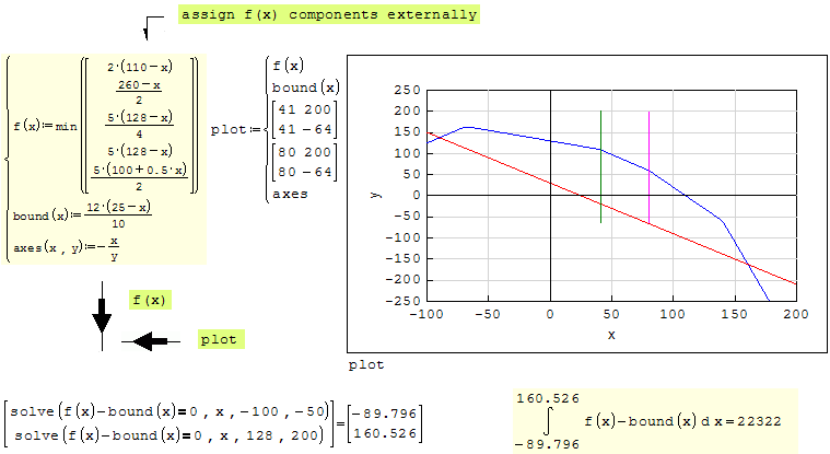

#4 Posted: 9/28/2019 1:21:02 PM
983 likes in 6866 posts.
2D Plot Discontinuous [min(,)].sm (14 KiB) downloaded 61 time(s).

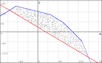

#5 Posted: 9/28/2019 2:31:28 PM
... Dichotomy added for solving in the complex region.
2D Plot Discontinuous [min(,)].sm (27 KiB) downloaded 72 time(s).
#6 Posted: 9/28/2019 6:35:33 PM
filling the loft added.
2D Plot Discontinuous [min(,)].sm (44 KiB) downloaded 73 time(s).

#8 Posted: 10/1/2019 8:35:03 AM
but how do you set your graph axis
1. Dispose the plot from plotting using Smath @ QuickPlot
zoom, shift left/right, up/down ...
2. Plot on the X_Y, set the X ± limits, Y ± limits.
3. plot ... 4. specify the traces from "list"
As simple as explained, no sweat ! ... Last plot.
2D Plot Discontinuous [min(,)].sm (44 KiB) downloaded 108 time(s).
