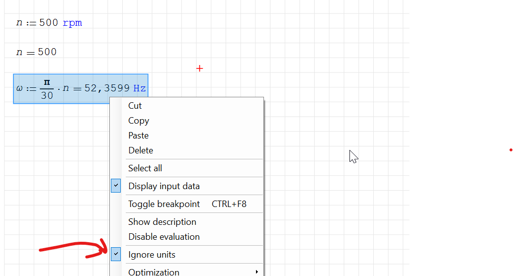

UnitaSilenziate.sm (2 KiB) downloaded 91 time(s).

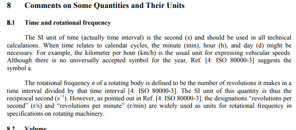

We are getting closer. A specification in rpm is simply a frequency. The tachometer in your car does not indicate angular velocity.
By the way, the NIST document above gives the conversion factor between the frequency in the unit rpm and the angular velocity in the unit rad/s.
It does not define rpm as rad/s.
rpm and rad/s are two different units.
to complete this:
The NIST document (https://physics.nist.gov/cuu/pdf/sp811.pdf) defines rpm in chapter 8.1 as (rotational) frequency:
At the top of page 54, you will find the table caption
and further down the conversion factor.
Try to harmonize this with the Smath definition...
It is quite possible that in older textbooks rpm is defined contrary to today's SI usage.
But a modern program should perhaps conform to the current SI standard?
(By the way, in Mathcad 15 it is also defined like in Smath. But this does not make it better).
regards, Johannes
