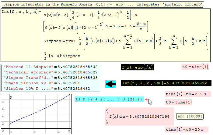

SMath Forum SMath Studio Samples SimpsonRomberg 1 Pages (1 items) SimpsonRomberg - SimpsonRomberg - Messages Go to last post #1 Posted: 9/4/2018 11:44:05 AM Jean Giraud 983 likes in 6866 posts. Group: User This test function is enough to drop dead on the failure of ordinary Simpson !The Simpson-Romberg integrator will help your project survive.The naive look of a function is no indication of easy integration ... Ah !JeanIntegrate SimpsonRomberg.sm (13 KiB) downloaded 87 time(s). 1 Pages (1 items) New Posts No New Posts
