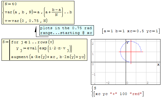

Hi. Without doubts Viacheslav use of him plugin is the better solution. But here some examples about how to setup the plot of a parametric curve using native SMath plots.
circle.sm (30 KiB) downloaded 113 time(s).
Also, you can see how to determine a circle given 3 points in the space by Ber7 at https://en.smath.info/forum/yaf_postsm54516_AlgLib-3-1x.aspx#post54516

WroteFrom native maths in native Smath.
... code it as a generalized companion utility.
Circle Complex.sm (14 KiB) downloaded 99 time(s).
