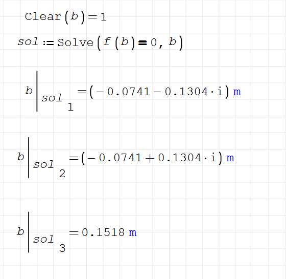

Dear all, 1st off - I am new to SM and experienced this problem with simple structural stress equation (stress due to bending) that I am unable to resolve - see attached. Solver returns error "No real roots".
I know there is as solution but I am unable to accomplish it.
Q1: Please advise - what am I doing wrong?
Q2: What is a best way to solve this as a system of equations (instead of substitution in order to arrive to a single eqn presented)?
Thanks!

Considering the internal solutors of Smath, the only one who contains the units of measurement is "FindRoot". Otherwise there are all the solutors of the plugins (something has already been proposed to you for Maxima).
Also careful not to fix "b" with a value, otherwise it is no longer an unknown for the solutor (For this, Clear ( b ) was used in the example with Maxima).

Well, you have a solution with Maxima, another with FindRoot ... this is a solution with solve or roots.

#6 Posted: 8/4/2022 4:45:46 AM
Dear experts,
Thank you for your solutions! I like the elegance presented which answers my question Q2 above on substitution.
Re units / unitless project:
I eventually managed to solve it with polyroots (before reading your posts) after rearranging the eqn in the form of polynomial order b^3 (disadvantage: I do the math instead of SM..).
What I noticed is that with units result is 0.152 m while unitless returns value 3.8664 ratio of these being 25.47 which is (close to) units ratio mm/inch.
Coincidence or Bug?

#7 Posted: 8/4/2022 5:42:15 AM
WroteConsidering the internal solutors of Smath, the only one who contains the units of measurement is "FindRoot". Otherwise there are all the solutors of the plugins (something has already been proposed to you for Maxima).
5-6-14-ser.sm (88 KiB) downloaded 61 time(s).
Thank you Sergio! I like the elegance presented.
However, changing initial guess value (b0) returns different results...(?)
For [b0] between 1 mm to 300 mm result is 152 mm while for b0=500 mm returns 145 mm, for b0=600 mm result is -39 mm. (?)
What is going on here?
Why this sensitivity to initial values and different results ?
#8 Posted: 8/4/2022 8:31:42 AM
These are non -linear equation, the solutions also depend on the research interval (especially with numerical solution methods) it is appropriate to proceed with a sanity check and sometimes trace the graph of the function to identify the search interval.

#9 Posted: 8/4/2022 7:39:26 PM
Hi Ante. Another example about what important is work with units, as you well point too. And the Smath relevance just because is the only one unit friendly math program today. Notice that taking out the units requires the introduction of their multipliers like giga, kilo or mili in the unitless version. So there are not a bug there.
#10 Posted: 8/4/2022 7:41:22 PM
WroteQ1: Please advise - what am I doing wrong?
While solve() and roots() can't work with units, you can "trick" them by altering your equation.
And there are many possible ways to solve with units, please check the examples below.
