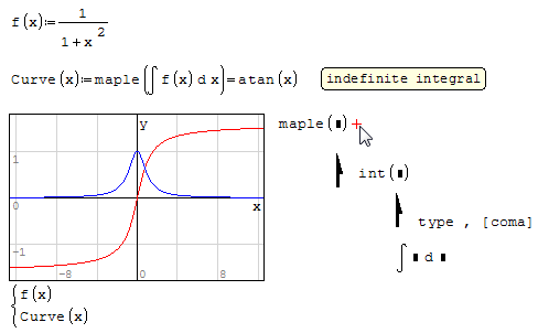

How do I integrate symbolically?
#2 Posted: 5/10/2018 9:54:23 PM
983 likes in 6866 posts.
How do I integrate symbolically ?
Generally, like this.

For reference, I just installed SMath. I installed maple. Where is the integrate sign located in the program?
Hi Ryu
Welcome to the forums. Jean's first post outlined a how to create the indefinite integral, although it might not have been clear.
For example, to create the integral for x^2, you can type "int(x^2,x)" without quotes.
I do not believe there is a toolbar button for the indefinite integral.
-alyles

Thankyou. int( x^2,x) was what I was looking for (and I see now what that first picture was suppose to be /headdesk). I tried the example mentioned above with maple installed but I don't see the answer like I saw above. I see this instead.

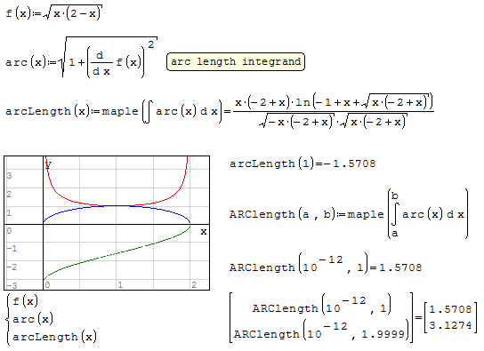

Copy the image, paste in blank work sheet ... try to do it yourself.
Try hard !!! rescue yourself by downloading the work sheet.
It should work in your latest Smath version.
Integrate Wisely [Arc Maple].sm (8 KiB) downloaded 163 time(s).

... be productive to integrate, try it.
#17 Posted: 5/11/2018 1:44:31 PM

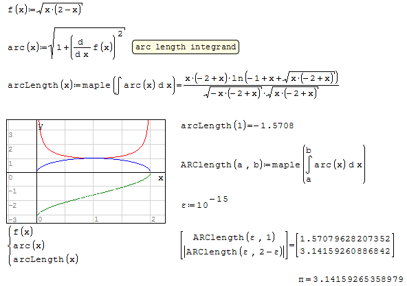

... this attached example is of prime importance.
It shows by how much the Simpson integrator can be OFF track !
Not even the first decimal is true !
Integrate Wisely [Arc Lagrange].sm (44 KiB) downloaded 160 time(s).
