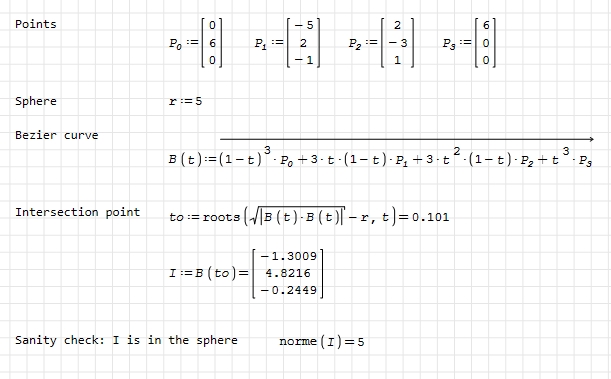

Hi. In the attached how to solve the problem numerically. Notice that B(t) must to be defined using vectorize, because SMath don't expand the scalar by vector products.
Sphere and Cubic.sm (8 KiB) downloaded 79 time(s).

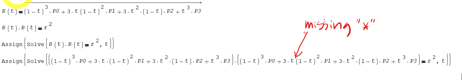

OK, I've fixed the error, but now it says: «r is undefined». Sorry, it's really hard to understand what to do and I can't find any proper docs about it...
Sphere and cubic Bezier curve intersection points.sm (4 KiB) downloaded 76 time(s).
#13 Posted: 9/16/2021 8:43:30 AM
Necronomicron
Necronomicron
0 likes in 8 posts.
I really don't get what's wrong now...
Sphere and cubic Bezier curve intersection points.sm (12 KiB) downloaded 85 time(s).
#14 Posted: 9/16/2021 9:40:26 AM
